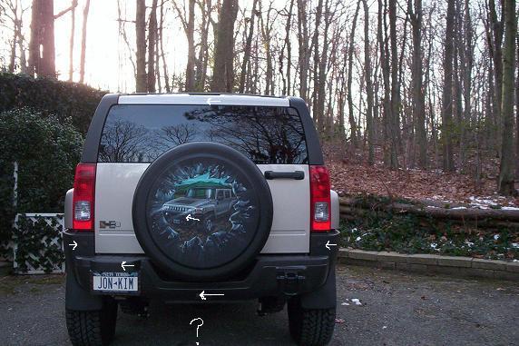

Next week im getting an eclipse dvd nav rear cam installed. Not sure where to put camera.I was thinking High above spare or maybee low in bumper maybee on ledge for lic plate or in the black cap on left or right side of bumper.and last maybee on spare tire cover in foglight of airbrushed h3 if they can have a disconect so I can get cover off.Any other Ideas?

The two spots you point out on the bumpers have bolts behind them, so that may not be a good place for them. I cannot tell if you have the trailer hitch back there, but if you do: Next to your trailer hitch may be good. There is a plate next to that you could punch though. up higher on top of your truck wouldn't be bad either, but you may have the spare tire issues the H2 guys have had. I'm not sure how close to the truck you want to view. Some people have it point back quite far and other have it pointed to see within 12" of the bumpers.

Why not mount the camera on the upper corner of the rear window on the INSIDE? It's protected from the elements, theft and wheeling mishaps. Plus, then you can move it around if you need to.
12-24-2005, 03:42 PM
If you pop off those caps on bumper there is plenty of room for camera.I dont have a hitch.Putting behind glass might not work well with the factory tint.

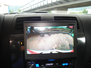

I think, lookingwise, the best place to put a rear camera is just above the license plate.
12-25-2005, 12:11 AM
Location: JAPAN
Posts: 142
Here is the view.
12-25-2005, 05:00 PM
Looks like a low view whats at the top and bottom of screen.

Just came back from installer he wanted to look at h3 first to figure out camera mounting .He recomends putting it were bb put it on licence plate top but drill hole and flush mount it in the plastic.Also he recomended fish eye view.We tested view with a portable and this seems the best.Other option was under spare on bumper and drill bumper ,tire is in the way a little that way. He feels the camera is more protected near licence plate.(like for water forging and mud splash)I think Im going to let him install a viper alarm/auto start at the same time .He has to order the camera and correct on star adapter so looks like next week for install.
