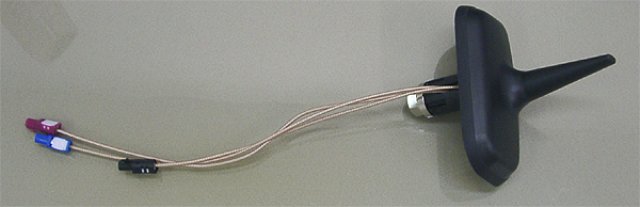

f5fstop, I would appreciate if you could tell me which wire of two connectors coming into factory head unit is for GPS signal. I'm planning to use it for aftermarket Navi system because Onstar and XM radio is useless in Japan.

The GPS is a coax, same as for the regular antenna. However, it might be a thin coax, versus the larger coax used for standard AM/FM antenna. Either way, it will be separate from the normal electrical connectors.

Correction to my reply, I was tired. The coax from the GPS goes into the vehicle communications interface module (OnStar) and from the VCIM module it goes to the radio, as a deciphered signal.
HummerTech...
All the H3s have a GPS antenna, it is part of the Onstar/XM antenna on the top of the vehicle (called the shark fin). Onstar requires GPS to locate your vehicle in case of an accident. However, you are correct for the Nav unit GPS antenna being mounted under the dash.

f5fstop, thank you for your reply. Could you tell me where the vehicle communications interface module is located ? The shark fin in the picture is not the one for H3, but similar one. A shorter caox with a black connector is for GPS. I believe that the one for H3 should be the same.
Hummertech, I know that an aftermarket Nav system comes with its own GPS antenna. But, I want to use the shark fin because it's already installed on the roof where the reception level is highly good.

Similar, but not the same. For some reason, GM thought the underdash antenna would be better for the NAV, can't say why, but do know from my own experience with GPS units, the plastic in the dash does not interfere with the signal.
VCIM is in the dash on the drivers side...I believe. Small unit.
