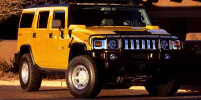

That is very helpful. I will (or I'll have the dealer) check my Z height adjustment. Here's a pic of an H2 from an official GM/H2 web site. The thing looks like it's squatting also!

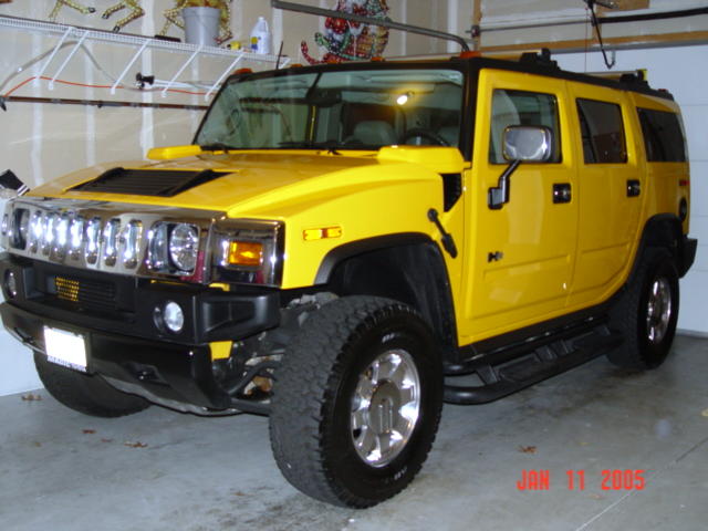

Here's my new (to me) 2003 H2 with 17K miles and air ride. It squats as well with a 9" measurement in the rear and 8"s in the rear. Damn! Back to the dealer!
