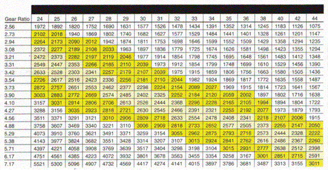

Old 07-29-2005, 06:02 PM
HGW HGW is offline
Posts: 932
HGW is off the scale
This chart is for 1-1, not overdrive--in third gear (1-1) you need 31's simulate 4.56.
The calculations I do are for rpm at the end of the 1/4 mile so you do not run out of tire, causing a shift to OD in the 1/4
