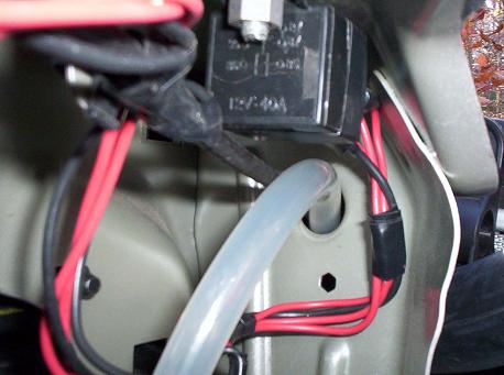

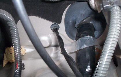

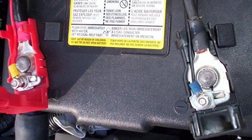

You can get a wire or small cable through a grommit on drivers side firewall pic 1.
You can tap into 12 volt(you will need a fuse on + wire) and ground at battery you must match nut 10mm and double nut it because battery nut acts as tightining bolt and will not exept a eye loop.pic 2.(You can also tap in to 12 volt in the underhood fuse panel on drivers side)
If the horn needs more than 10 amps you need to install a relay . I mounted mine on top of grill/radiator suport in existing hole on drivers side pic3
There are more pics in the tech h3 section the under installing 12 volt airhorn
pic 1
Old 12-03-2005, 11:11 PM
fourfourto's Avatar
pic 2
Old 12-03-2005, 11:12 PM
fourfourto's Avatar
pic 3
