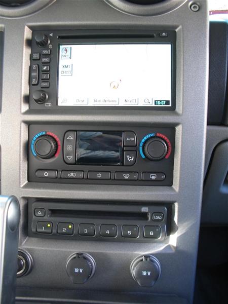

LoLo...You can install the H2 factory touch screen Nav and XM. Dealer will tell you it can't be done, but many of us here have done it. Do a find for "nav" or "TNR" and XM. You'll find many posts from Klaus and others on accomplishing this. You can buy the complete set from jpcustom and just have a good shop install it.
Jonahs
Old 07-01-2005, 01:05 AM
Klaus's Avatar
Klaus Klaus is offline
Location: CSA
Posts: 2,511
Jonahs is correct. The GM TNR and XM Radio kits work fine an an '03.

I also junked the OnStar and installed a GM 6-Disc CD Changer.
