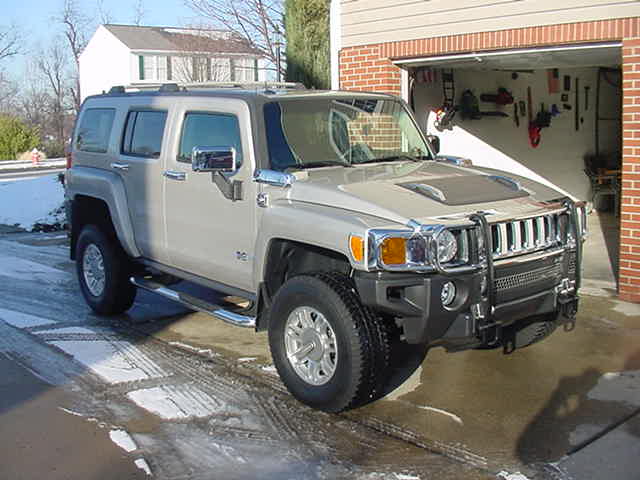

Posts: 154
Make sure you mark the bolts and turn them clockwise to lift the front end up. Front end alignment should be checked.
Here is a photo of my H3 with 2 1/4 turns. Front end was out a bit after adjustment

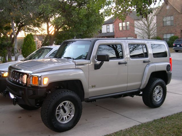

Posts: 35
Do It...Do It...Do It...
2006 H3, Torsion bar tweek and 285/75r 16 Bridgestone REVO tires
