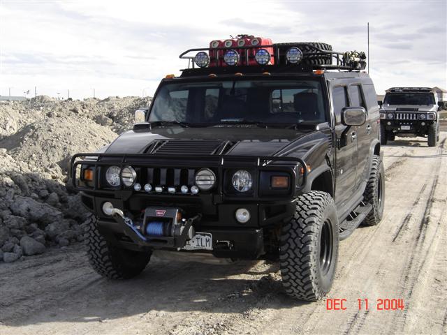

Front mounted (although it's on the rear today) Warn 9000 MM...
Old 12-23-2004, 04:20 AM
Yeah, very nice- except for the chrome mirror caps and door handles. And short people steps.
BTW, you're aware that you have a light fetish, right?

Can anyone tell a newbie why Adam's winching cable is blue? I've never seen that before.
Old 12-31-2004, 08:29 PM
<BLOCKQUOTE class="ip-ubbcode-quote"><font size="-1">quote:</font><HR>Originally posted by GeorgeSSSS:
Can anyone tell a newbie why Adam's winching cable is blue? I've never seen that before. <HR></BLOCKQUOTE>
His winch cable is a bit under the weather.
That is winch rope that he has on there. this rope that he has is just as or almost as strong as the cable. Benefits are it it were to snap, the rope does not store energy. it just drops to the ground. the cable can kill you if it snaps and hits you. the rope is also much easier to wind! PM Adam and he can share more about it. I don't have mine yet so I don't have the specs or anything on it.
