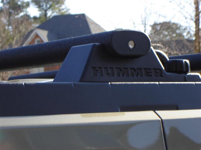

Ok, I finally got around to Line-Xing the roof cross bars. I dreaded taking these off because I cracked some plastic on the old truck.
Anyway, this was a lot easier. Start by removing the locks and then the rubber strip that goes across the top. Use a #20 Torx bit with an extension to get at the 4 mounting screws. Remove those and take the bar off. Pretty easy.
Take it to the local Line-X shop and have them do their job. When telling them how to do it, make sure you tell them NOT to Line-X the channel for the rubber strip. The bonding agent is not necessary, but I had it applied.
To reinstall, start with the rubber strip. If you've kept it in the house, warm, it will be easier to reapply. I thought it was a PITA.

Old 12-21-2005, 03:20 PM
There may be some product you need to trim in order to get the strip to mount all the way down. Just use a razor knife and cut it away.
Put the bars back on and tighten down with the Torx bolts making sure the sides are even.
Lubricate the lock mechanism while you have the lock off. (You might as well. They get tough to turn.) If there is product on the very ends of the rails, you will need to use the razor knife to cut it off. You only need to clean the bottom half of the end to get the lock to function properly. This only takes a few seconds.
The lock should slide on and work now.
That's it.
Piece of cake.

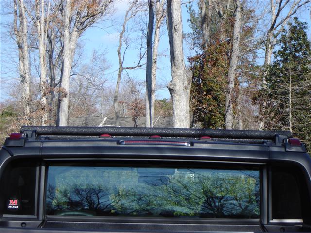

One more pic for the hell of it.

Old 12-21-2005, 07:05 PM
LOOKS GOOD KEN!
BTW- nice poseur sticker. that truck hasn't been to Moab....yet.
Old 12-21-2005, 07:21 PM
LOOKS GOOD KEN!
BTW- nice poseur sticker. that truck hasn't been to Moab....yet. </div></BLOCKQUOTE>I was wondering if anyone would notice that. Hey, atleast I don't have all the trail stickers on there.
Old 12-21-2005, 07:34 PM
LOOKS GOOD KEN!
BTW- nice poseur sticker. that truck hasn't been to Moab....yet. </div></BLOCKQUOTE>I was wondering if anyone would notice that. Hey, atleast I don't have all the trail stickers on there. </div></BLOCKQUOTE>
LMAO! You should have a GONZO INN sticker.
Old 12-21-2005, 08:16 PM
I do, but I have to open the Owner's Manual to find it and that's too much trouble.
Does anyone know where my Gonzo Inn sticker would be?
