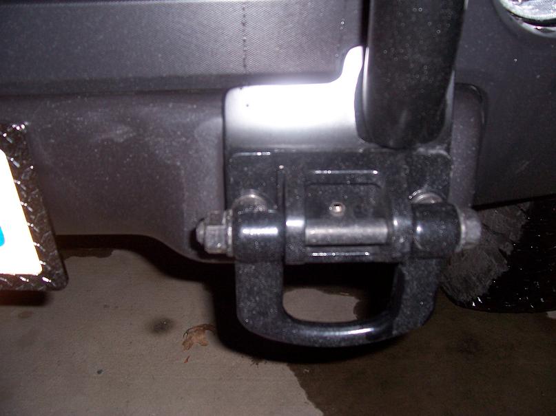

I just put a Aries brushguard on my H3 today. Well I tell ya, about halfway thru unbolting the bumper I said theres got to be a better way.. There was. I eyeballed the tow hook bracket right between the bolt holes and drilled (1/4inch ) out the retaining clip. It was a piece of cake. Bracket came off, Brushguard was installed in minutes. With the tow hook installed you cant even see the small hole now. The D ring pretty much covers it. The directions I got for unbolting the bumper and removing the wheel house panels turned my little project into a all dayer. If you dont mind drliing a small hole to release the tow bracket you can install a brush guard in no time. Hope this helps.

Thanks I got it Im listing pic below.
You could put a allen head in that hole it would look good or rubber plug

It wasnt that hard to drill out. I missed the first retainer by a 1/16 inch and hit the second one dead on. Saved alot of $$$$ by not having someone else do the fender and wheel house removal and installing. It dosnt sound that hard to remove fender until you crawl under there and try it. My directions were very generic. Heres a pic Filled in the little hole with a rubber grommet yesterday..Looks fine now
