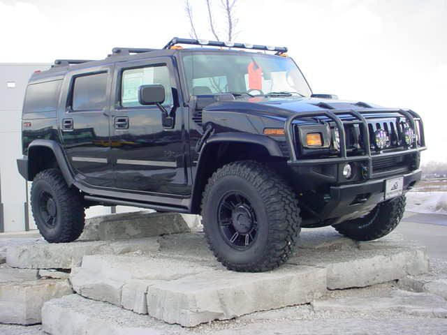

So, the Goodyear MTR is back ordered indefinitely so far as I can tell. I don't want the Swamper SSR or IROK because I do too much highway driving and I need to get more than 20,000 miles out of them. That leaves the BFG MT, which is a great tire but I've heard there are rubbing issues because it is slightly wider than the MTR.
Does anybody have these?
How bad do they rub?

Travis had those tires before his Rancho lift and said they rubbed a bit, but it wasn't bad.
The MT/R's I'm using right now rub pretty bad too, so I'm not sure why people say they don't.
The rubbing only happens on sharp turns, and is certainly negligable compared to it's gains.
I love the BFG Muds, but I'm concerned with the reports I've heard of sidewall damge while rock crawling. Which I do a lot more on rocks, than in Mud. But they do kick ass in mud, no doubt about that. Way better than MT/R's for sure!

Yeah, I've nosed around some other forums and heard about sidewall tears. The MTR is my first choice but I can't find them and no one seems to know when they will be available. I ran BFG MTs on my D90 for 2 years with no problems. They were fairly quiet and handled well except in wet weather. I could have the center section on some MTs siped to help on road manners, especially during rainy conditions.
I should have bought those 6 MTRs off eBay but I missed the end of the auction. They only went for $211 a tire. Maybe I can find another wealthy H1 benefactor looking for a charity case.??

I have noticed the last time out that with the MT/Rs aired down to 18 I had some rubbing on the front sway bar but nothing that would out way the advantage that they provide.

I looked into Xterrains a while back. They will rub terribly so I would assume the Cepek would as well. The height is not really an issue; width is. That's why the MT/Rs (slightly narrower) rub less than the BFG MTs.

would a 2 inch lift fix the rubbing problems of 37's??

well if they rub when turning due to width you can:
1. get new wheels with corrected backspacing.
2. get wheel spacers.
If they rub in the fenderwells when flexing due to tire height - lift it.
you can probably adjust your steering stops to stop it from rubbing which will limit your turning radius - not a bad 'short term' solution until you can get the right tires/wheels.

The stock 35" BFG ATs rub the swaybar at 18psi....

Did putting on the heavy bumpers, brushguard, and rack bring your clearance down any? I have been meaning to ask and you just reminded me.... <HR></BLOCKQUOTE>I never really did a before and after comparision.
But before I put on the 37's, I measured the distance between Tire and Fender in the front and back, and it was 1.5" lower in the front.
I corrected that with 3 or 4 turns on my torsion bars.

I just eye balled what looked like the highest point of the tire, and measure from there to the fender.
I wasn't exactly on level ground when I did it either.
Nothing scientific about it.
What paticular experience with my 37's has you questioning?
They are looking at my front end now, and said it's the Control Arm and the Idler arm that have to be replaced. I also have a transfer case leaked, and various other damage to the belly of my beast.
It's really hard to say if the 37's can be blamed for any of this. I drive my vehicle pretty damn hard.

I haven't noticed any fender rub, just sway bar rub. But it's enough that if I turn my wheels completely and drive, I can feel and here them eating into the swap bar, and my sway bar is rubbed pretty raw. I think it's a very small sacrifice.
And if it seems like I'm complaining about the 37's, I'm not. They make a huge difference in my opinion, in favor of the off road handling.
