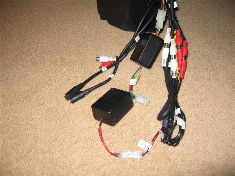

I removed the center console for an unrelated project and when I put it all back together, the DVD has power but the headrest monitors for the rear will not turn on.
The white plastic connectors (see below) are seated. The empty white/square connector in the pic goes to a small harness that runs along the inside of the driver's side of the console. All RCA connectors in the bunch on the right are seated. The two S-video cables were connected. The two RCA connectors on the left were not connected (and I don't think they're supposed to be).
One thing that concerns me: When I originally took the DVD/storage box out, the casing around the small plastic box nearest the DVD came off. I didn't bother to put it back on until it was time to button it all back up. The components in that box were open to the elements and potentially, contact with metal parts in the console base.
Is there a separate fuse for the monitors that if blown would still allow the DVD player to receive power? If so, where is it?
Could the components in the small black box have gotten fried?
Any suggestions? I'd be thankful to hear them!

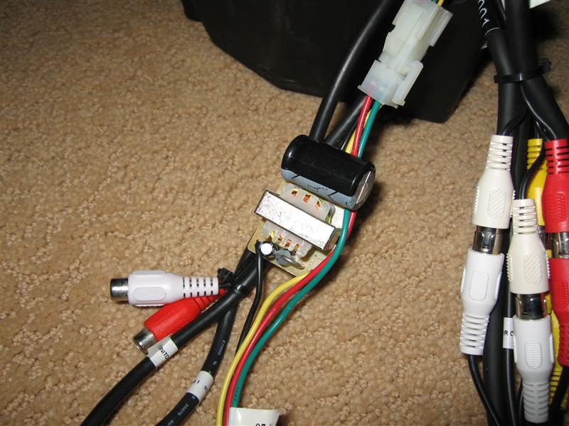

Small black box looks like a filter. </div></BLOCKQUOTE>
Pic below is with the black box off the eletronic assembly.

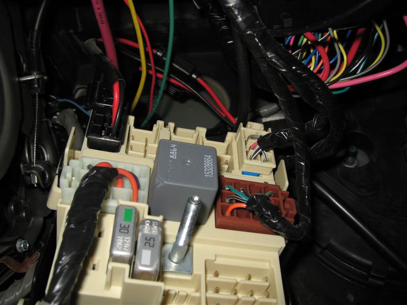

The small harness that plugs into the available white/square connector above has three wires -- one each red, yellow, black. What if one powers the DVD, the other the monitors?
Chased the wire harness from back to front and found it terminates in the black plug in the top left of the below picture. Pulled that plug, checked continuity on all three -- one open. An in-line fuse is the culprit.

Not sure why the fuse blew but if I had to guess, I'd say it was when the one filter was not covered. It was laying solder-side down on the metal plate under the storage box.
