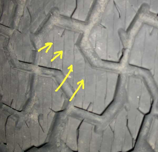

The "siping" on stock tires is not what we're talking about.
One would think that someone with your limited off-roading experience & ability would be looking for any edge you could get.(Did I say that out loud? Oopsie.)
Siping greatly enhances a tire's grip in all conditions.
The picture below is the stock tread siping.

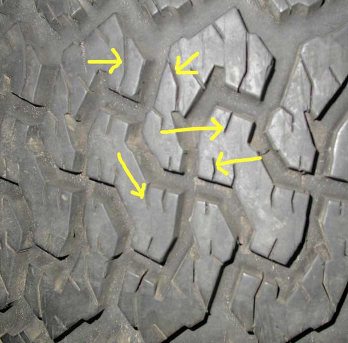

Notice the difference with the extra siping in this picture. It makes a huge difference in grip, performance and tire wear.
This is a picture of my A/Ts that have about 50-60% left of the tread. Notice there's no chunking or irregular wear. And I beat the piss out of these tires.

Gotcha, DRTY. You may recall, I probably spend as much time on snow, Ice and Verglass (black Ice) as anyone. The stock tires have served me extremely well (must be all that time in snow country building my skill ). But I do appreciate the education and the pix distinguishing the aftermarket from the factory siping. Thank you for sharing your expertise. I still have plenty to learn, Deity Dirty.
