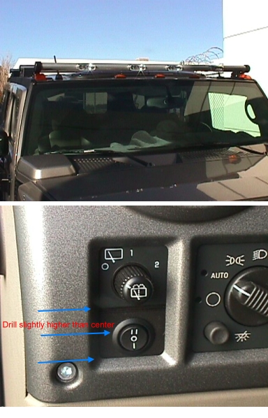

Just installed my light bar. Nice product & instruction okay (pics could be larger). If you locate the switch below the wiper switch, make the hole slightly above center, about 1/32". I centered mine then had to trim the box at the bottom to make it work. And there's not much there to trim.

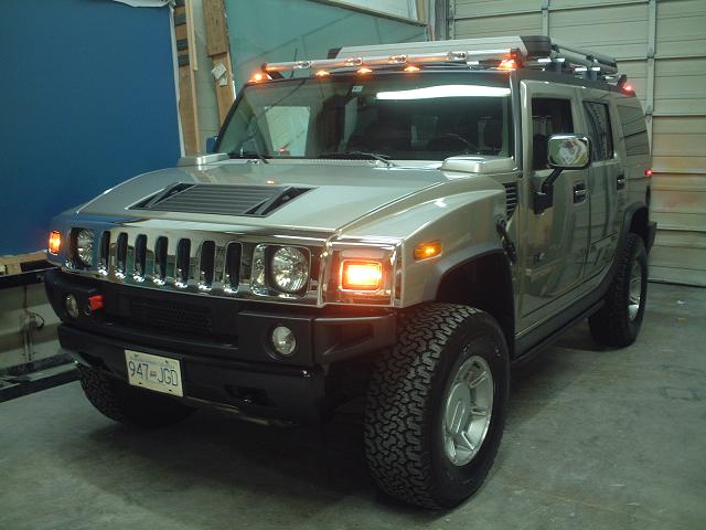

That looks very nice Vegas! I like the round switch, is that the one that came with the kit? I'm installing a SMA light bar right now (today) but this one has a rectangular shapped switch

Yes, the switch came with the kit. If you like most auto parts stores have assortments of switches. Just be sure it's rather small. Not much room inside the box.

Hey LV your exactly right about the switch location. I installed mine about three weeks ago and had the same problem. You would think they would tell you that since that is one of there suggested mtg locations

Yeah Tracey, since they suggest that location you would think they would provide a little detail. It took almost as much time to get the switch mounted as the rest of the install. Thanks for the great service on the winch. Nice product.

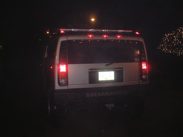

I've had mine for over a year now and theys the ****s! I put a front set in the back too. They came out with a rear one a few weeks after but I think it looks ugly.
Old 01-29-2005, 05:04 AM
Rear action.

Hi Dennis. Really like the XTC & the rear one on your truck looks great. If you're keeping your '03 and really interested in the express sunroof idea check my post http://elcova.com/groupee/forums?a=tpc&s=2826088551&f=6706011751&m=503103610 1 I think it might work & I'm going to call them Monday. Where's your winch or is that an old pic?
