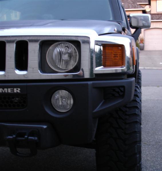

Side. For some reason the rear tire looks small in these pics but in person they look huge.
2003 Yellow H2 LUX (Sold)

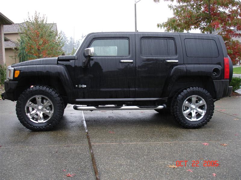

10-21-2005, 05:13 PM
Join Date: May 2004
Location: The Carolina's
Posts: 1,198
another

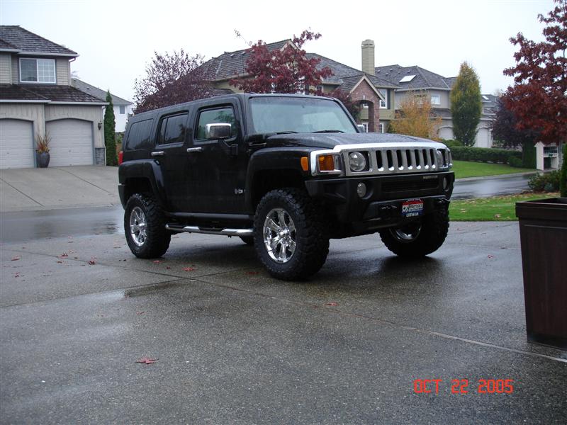

10-21-2005, 05:15 PM
Join Date: May 2004
Posts: 1,198
From this angle it looks like it sticks out a little but it really is near flush. With the 35's I could see the tires stick out as I look in the side view mirror while driving. With these you can't see the tire at all.
Best of all, with mud flaps up front no "rooster tail" or rocks chipping away at your paint!
