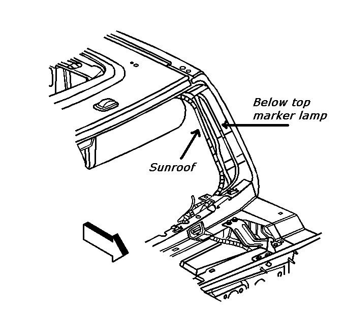

VTSTOMPER...the only drains that run through that pillar is the sunroof drain. If everything else is dry above the dashboard I would suspicion a leak in the drain below the dash. I'll research further & if I find something useful I'll post. Sorry guy.

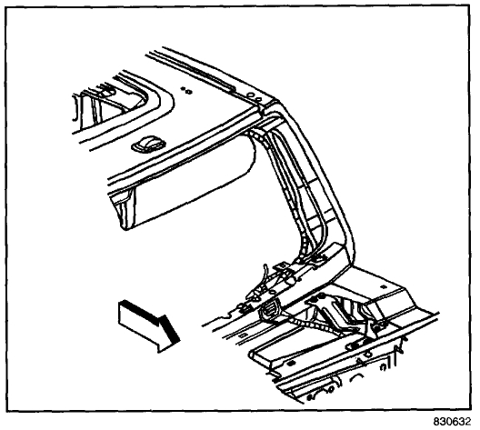

drain routing. This might help.

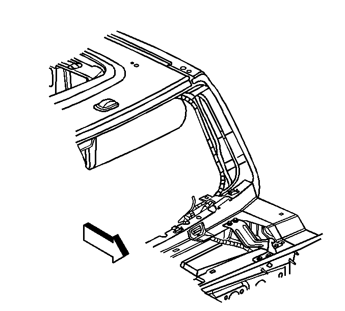

Here is the front drain hose schematic, if its any help to you.

Damn! You beat me by one minute with the pic!

Thanks guys...maybe I will snake the drains.
Does this make look right?
