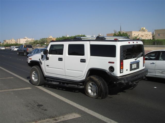

i have recently purchased a Hummer H2 in Kuwait and 1mth after driving it, some idiot smashed into the back of me doing 150kmh, they did a good job of smashing up the rear end. I nowface a problem with the back axle and trying to find to a replacement back axle casing, can anyone out there help me out.
PLease see picture of my accident on 1/6/05

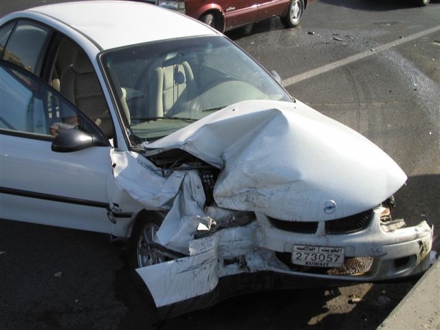

Thanks for the thread, i will check it out and yes i am only looking for the casing and nothing else.
Here is the picture of the Chevy Lumina that hit me.

I had no idea there were so many GM cars and trucks on the road there.
Sorry to hear about the wreck...I hope it is all sorted out for you. On the back (in your pic) door it looks like the gap is tight on the side and wide on the top...can you still open that door ok?

i will hopefully get the coding today from the mechanic and then see what is available, the local dealer for Hummer says that 30-90 days before he can get a axle casing, i just dont get why it will take so long. I have seen about 150 Hummers flying around Kuwait over the last 3 months - they are as popular as any GM truck around. I have all other parts for the axle, gears etc.
As for the back door, we can open it ok, now that the axle has been taken off, all body work has sprung back into line with no visible marks which is a good thing. I would say that there is 50% of vehicles on the road are GM/Chevy models.

Here is the picture of the Chevy Lumina that hit me. </div></BLOCKQUOTE>Damn, he sure hit you hard. where did he end up in relation to your truck? It looks like he spun a bit. I bet you're glad you were in the HUMMER.

i was shunted from stand still position about 20mts down the road from when he hit me.
I saw the bugger coming down the outside medium in the side view mirror, so i knew it was coming and i could not do anything about it.
If i was in a car not a Hummer, i would most probably not be here.
Thank God i was in a Hummer.
