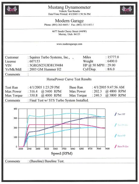

The posting of a STS'ed H2 dyno sheet would be nice. A/F ratio would help also. Lastly, please specify which type of dyno is being used and whether its an awd or 2wd unit.

Old 06-08-2005, 04:53 PM
h2turbo h2turbo is offline
Location: Orem, UT
Posts: 23
h2turbo is off the scale
The dyno, along with customer testimonials, pricing, etc. is all on the website.
http://www.ststurbo.com/hummer_h2
However, I've attached the scanned in dyno page to this message. Unfortunately it doesn't have the A/F ratio. Rick Squires, who tuned the vehicle, said it was in the low 11's.
The dyno run was done on an all wheel drive Mustang Dyno at Modern Garage in Murray, UT. You can call Christian at Modern Garage if you would like to verify. 801-262-4605.
Thanks for the question!
Ben

OOOps, you snuck the sheet in while I was typing. Thanks and it looks good.

Ben-
Thanks for the response. The dyno sheet looks promising. Although I hate to see a "one question answered, 2 more asked" thread happen, I would like to know how the auto tranny stayed in gear at full throttle w/o kicking down to the next lowest gear on the dyno run. If i give my H2 full throttle at 2400 rpm, it always kicks to the next lower gear.
