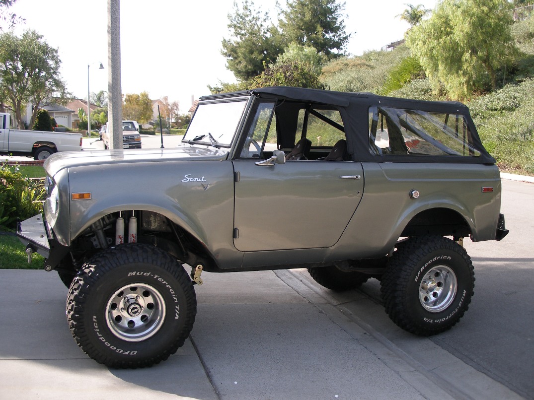

For the first time in my life I've slowed down and started to research my next vehicle. I'm am finally able to by a preowned H1 and make it my own. I'm not a stranger to offroading as you can see by my present beast. In case your IH impaired, it's a 71 800b (304 V8) Scout, ARB frt/rr, fully caged animal. ETC...Blah, blah, blah.
