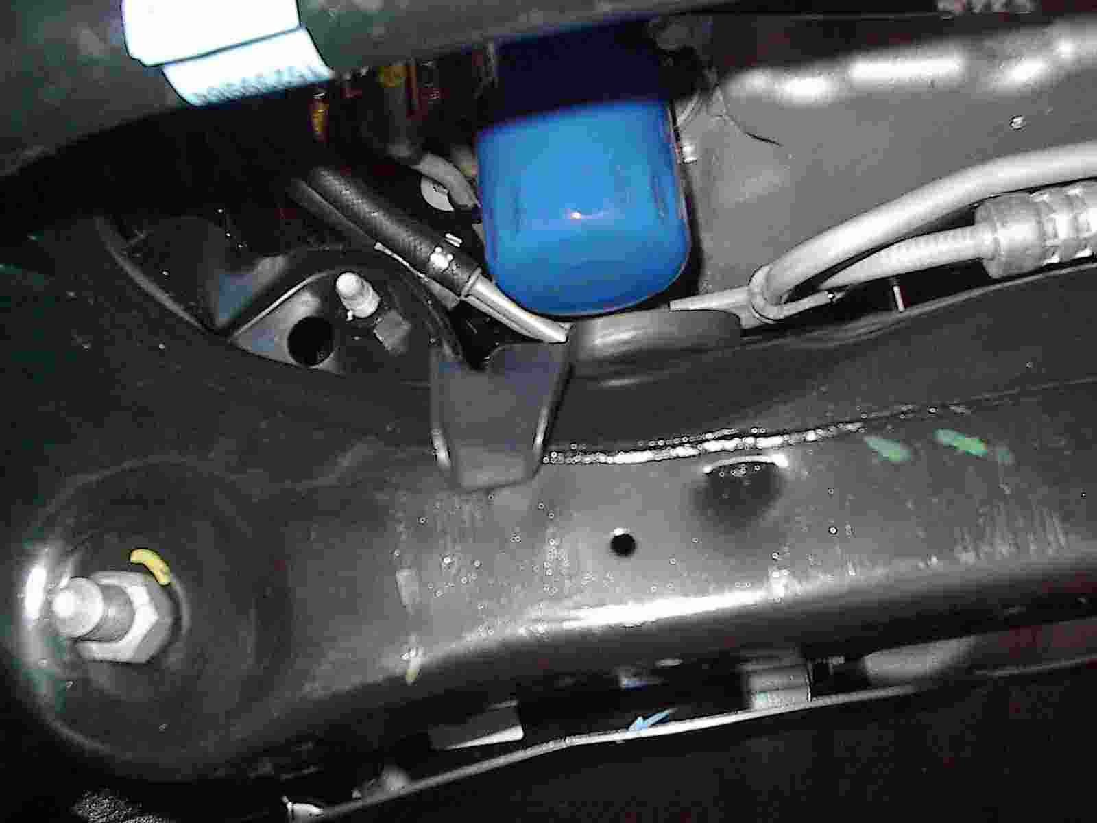

To change the oil without spilling oil everywhere it is neccesary to remove the two front belly pans. 6 bolts and very easy.
This is a photo of the nice funnel GM put under the PF61 filter to help avoid messes.
