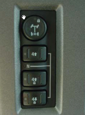

This is the rear diff lock and location.
