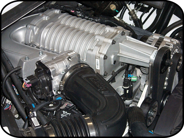

Here's the best intake kit:

<BLOCKQUOTE class="ip-ubbcode-quote"><div class="ip-ubbcode-quote-title">quote:</div><div class="ip-ubbcode-quote-content">Originally posted by Klaus:
Here's the best intake kit: </div></BLOCKQUOTE>
Hell ya!!! I just need to find a money tree.
</div></BLOCKQUOTE>Gosh, that looks familiar, but I.... I .... I just can't place it.
