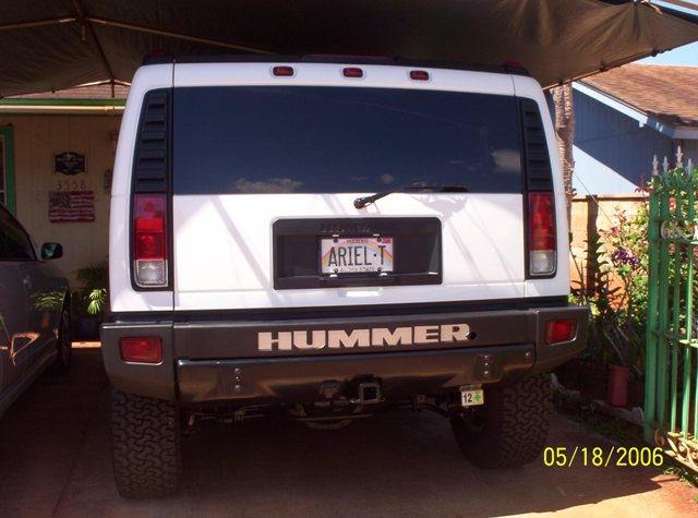

aloha...here is an 06 H2 SUV rear look like without the spare tire carrier...i took mines off coz i like the look without...
