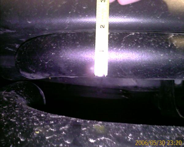

Default Re: Manik rocker panel tube protection vs. stock
Here's a pic of mine. These Manik rockers are 2 inches wide, hollow, and barely 1/16in thick. More solid than nothing, but don't expect much. I would classify them more for looks than function. I haven't had to use them and that's probably for the better.....
ok i stand corrected! Thank you guys for the effort. So GM is it?
