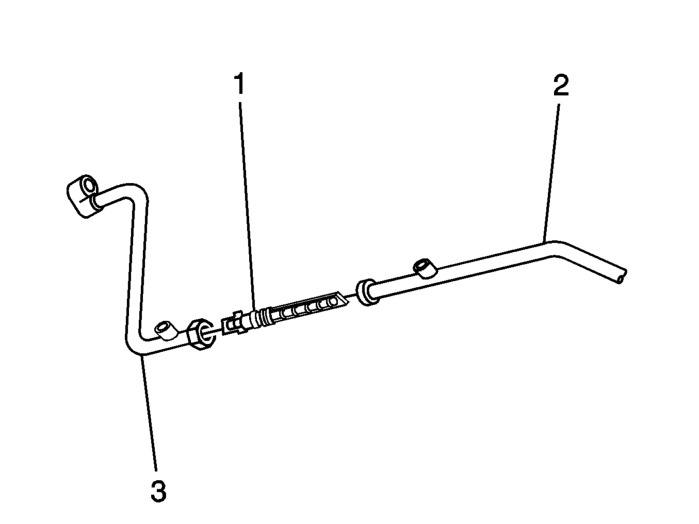

I don't see no stinkin arrow
Old 06-15-2006, 11:22 PM
Default Re: Is your AC not cooling correctly? Technical bulletin:
BTW, here is an orifice tube
Old 06-15-2006, 11:45 PM
Location: Charlotte, NC
Posts: 2,767
Actually, I think that's the problem. There is no arrow. There is suppose to be one... that's probably how they got put in backwards.
