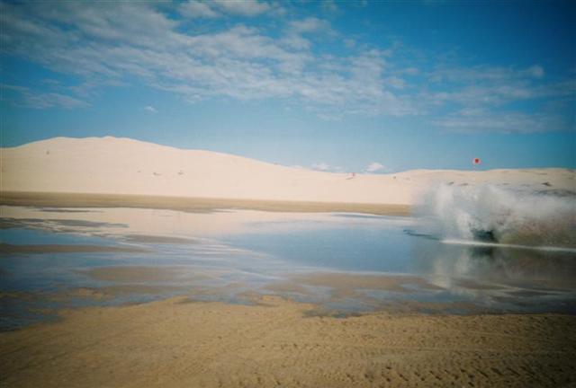

Old 06-27-2006, 01:43 PM
Default Re: HOW LOW CAN YOU GO???????
One of my favorite fording shots

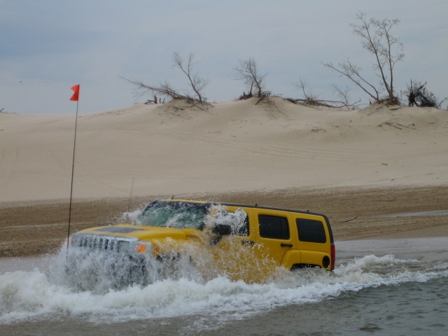

Old 06-27-2006, 02:54 PM
Hummer Guy's Avatar
Posts: 1,304
Hummer Guy is off the scale
x2!!
