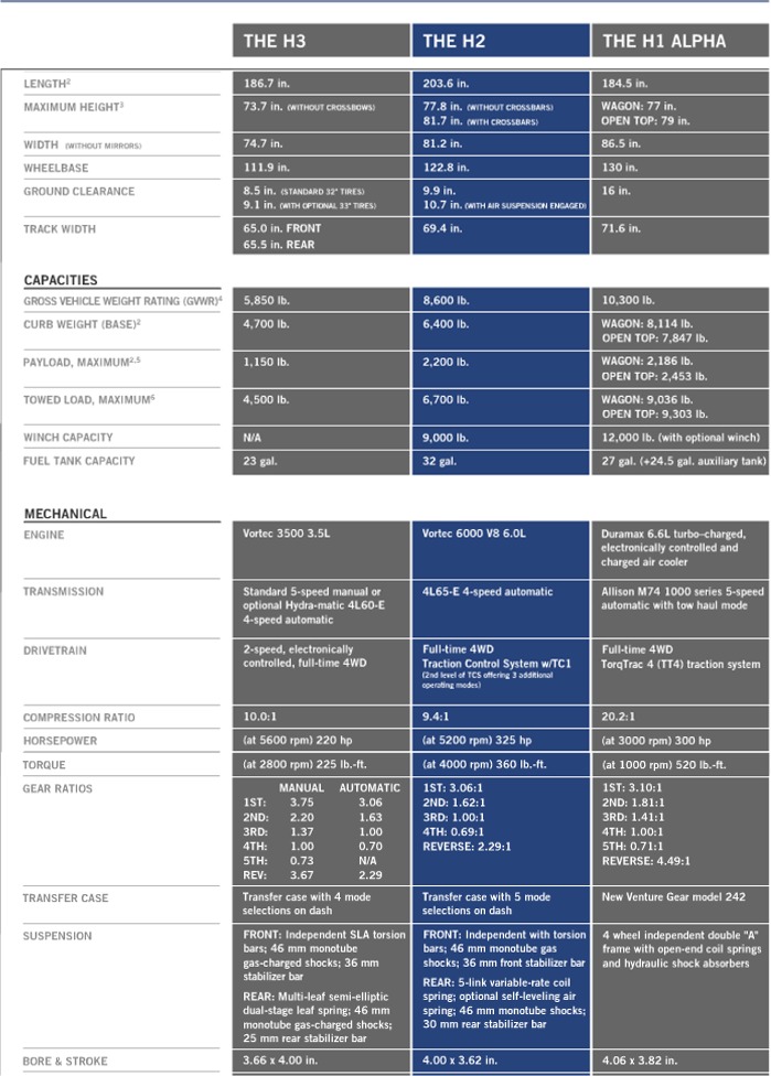

I picked up the capabilities guide from the dealer and thought I'd share some info. This book shows charts that compare the H1/2/3 to one another.
Specs listed are with 33" tires on the H3.
Specs listed for the H2 do not include the air susp. engaged
Specs listed for the H1 are for the open top.
H1 H2 H3
Wheelbase 130.0 122.8 111.9
Overall length 184.5 189.8 186.7
Front Overhang 24.5 32.6 31.5
Rear Overhang 32.0 34.5 35.2
Front Track 71.6 69.4 65.0
Rear Track 71.6 69.4 65.5
Overall Width 86.5 81.2 74.7 excludes mirrors
Overall Height 77.0 79.2 74.5 excludes roof rails,
Min. ground
clearance 16.0 9.7 9.1
Approach ang. 72.0 40.8 39.4
Depart ang. 37.5 39.6 36.5
Breakover ang. 32.5 25.8 25.0
H2O Fording 30 20 24
With the slight differences listed above, all three models can traverse a 40% side slope and climb a 60% grade hill.
I have seen these numbers posted before, but not all together. I thought these specs were interesting. most of us change out tires, some lift their trucks. So I wonder what these specs are raised to when adding 35" tires to an H3, 37" tires to an H2, 38.5" tires to an H1, a 4" lift or a 6" lift?
FWIW- I thought the specs were cool to see listed together.

For what it's worth...
The H1 Alpha is 2" taller than the standard H1.
Wagon - 77" vs. 75"
Open Top - 79" vs. 77"

well, that is all listed at hummer.com quite nicely. Thanks though

from website
