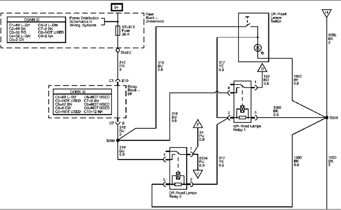

Where do I connect my fog lights to work off the stock switch in the celing consol ?

there are/is a relay(s) at the bottom of the dash just under the steering column.
Old 08-24-2006, 12:48 AM
Default Re: Stock fog light over head switch ?
or the easiest would be just to splice into the wiring harness out at the grill and use the stock wiring.
Put a relay on there for the trigger, run a POS back to the battery with some heavier wire than the stock.

What color are the wires that are connected to the switch, I dont want them on with the headlights ?

did you not have the original stock hummer fogs on the grill? If not, there is nothing out front to splice into, if so, it should be pretty easy to figure it out.

The switch is in the celing consol. There are no fog lights, I put them in the brush guard, but I want to use the switch
