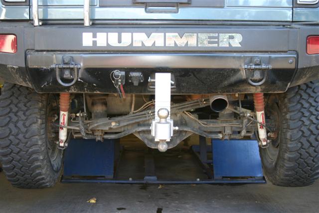

Default Re: trailer hitch question
Here's the one I use. I have air suspension, so I like the flexibility of the adjustable ball mount. It is a 10" drop with 2 ball sizes of 2" and 2 5/16".
