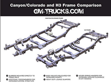

Old 09-22-2006, 09:29 PM
fourfourto's Avatar
Default Re: Tow Hooks
they mount right to the frame
