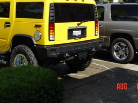

See below. The 305/45-22's are 33 inches whereas stock is 35 inches. It may look funny.

Go to www.1010tires.com and click the tire calculator link. Also, look at the my pic above again. There is no comparison.

325/50-22's all the way. Also, they look great in the Terra Grapplers. Our H2's have a lot of space in the huge wheel well. Getting a 33" tire in there will look rather odd - IMO.

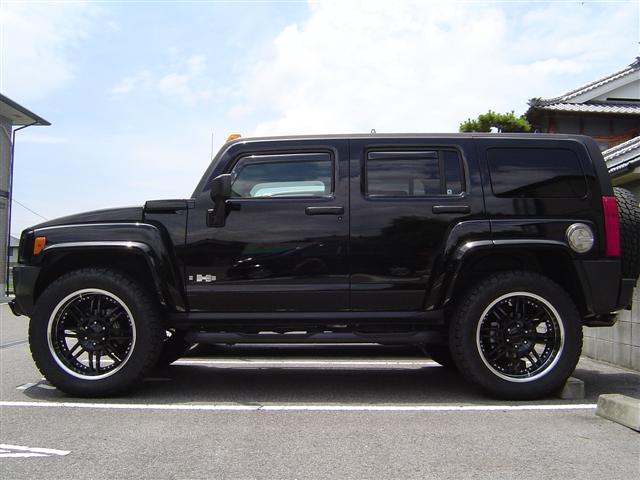

Have you seen this link? It's an H3 but the wheels are black KMC's with 325/50-22 mud tires. Ask him about the ride quality and braking. Who knows, it might work well in this case and the KMC's are lighter.
http://www.elcovaforums.com/forums/s...t=kmc+backseat
Yeah, thanks. I did see that one and have heard a few other people say they noticed no significant difference with the KMC's, but I haven't seen anyone go with the 305/45's. The terra grapplers look nice, but if I'm never going off-road, I don't know if I want to deal with the tire noise and extra cost.
