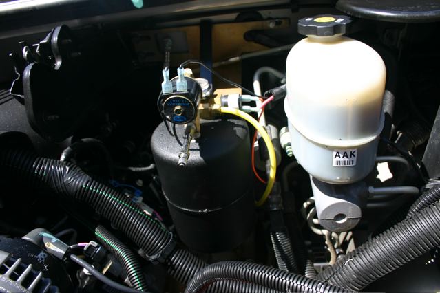

I went w/ these. They fit nicely under the hood of the H2.
Train Horns

Email this guy and he'll sell you some 1/2 air brake line that will work really well. Also, I do not suggest going w/ a kit from ebay. I went w/ a ViAir 480c Compressor, all 1/2" air line, and a 3 gallon tank along w/ the horns mentioned above. I also suggest going w/ a differnet solenoid to allow better airflow. Good Luck.

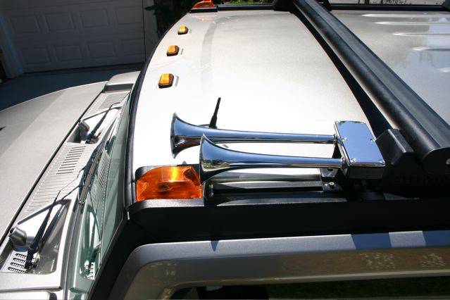

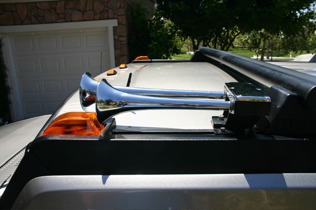

Default Re: Train Horn For H2

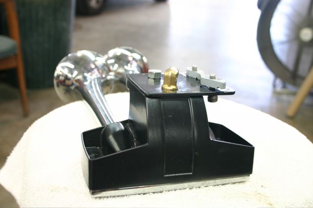

Here is my RealWheels Air Horn installed on the roof rack rails. It was pretty simple to route the air hose under the wiper cowl and up the exterior driver's side pillar trim.

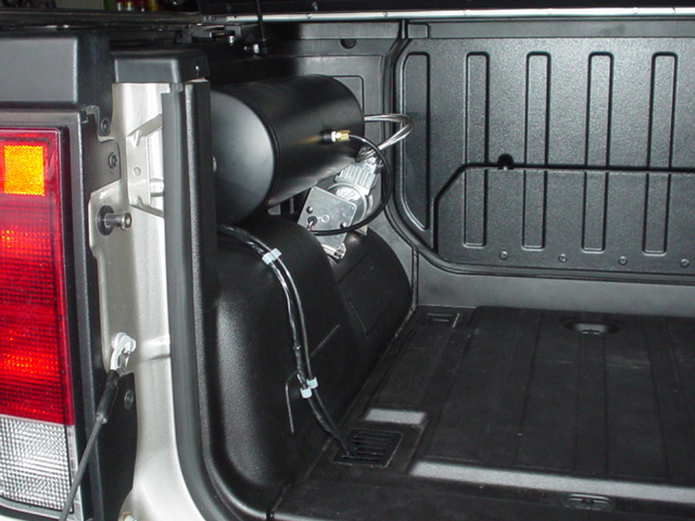

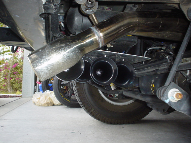

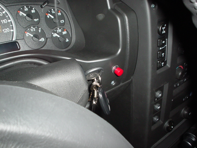

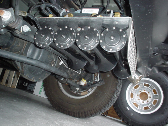

I have the hornblasters kit with the 3 gallon tank I believe. I have a setup on my Dodge Ram also. I have never experienced a hose break problem and I am running 160psi. There is very little room under the H2 to install. The set I run is a 4 horn conductors special and they are big. Here is the set up on mine. If I go offroad and need to remove them 2 bolts and its removed. As far as being worried about the hose breaking and ruining the compressor and draining the battery, just wire it to an on/off switch. Mine is also wired so when the truck is off, there is no power to the compressor, and also an on off switch to disable it when its on if I want.
These puppies are loud, same one as in the hornblasters videos.
