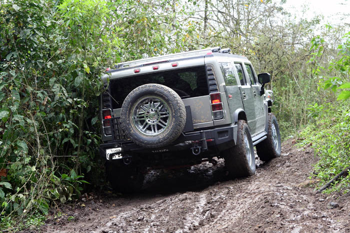

What I have is this. I extended out the frame, and have a set of ramps and the highlift jack mounted between the frame and the liftgate.
MB, can you post some detailed pics of what you did in there? Sounds interesting...
x2, what did you have to do to make the rim mount. What caused the rim not to mount? I guess I figured the rim would just bolt up there...my bad.
BTW- nice lookin rig.

Default Re: Will my spare tire still be useful?
Detailed pics - will take some and put them up next week after I go back home this weekend.
