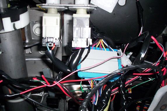

I must be a idiot I cant see a green/white wire.I do have some other wires and stuff from aftermarket auto start and radio ect.I dont want to be pulling down/yanking the wires around too much?

I just went out to look again the wires from key go down and to the other side of column than a harness comes down.it seems my installer taped up all those wires.Im not sure if i want to undo ?

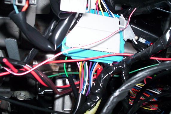

fourfourto's Avatar
another pic

Per the schematics, the connector should be light gray, but there could have been a change in color after the schematics were published (not unusual).

Anyway I untaped the wires taped up by installer and found that green/white wire(Duh it was right there but I couldnt see it without removing tape) so I hooked up a wire to relay and fridge only runs when key is in foward run position.This way it wont be as much a strain on the battery when using the dvd with truck off in accessory position.I mostly need fridge for day trips or weekend trips so It should keep beverages cool when needed.
