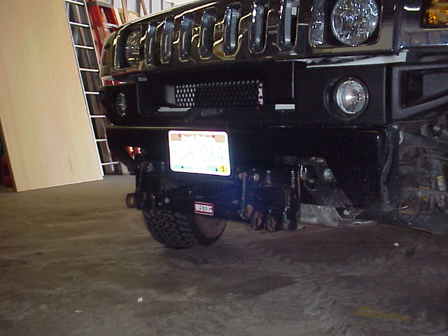

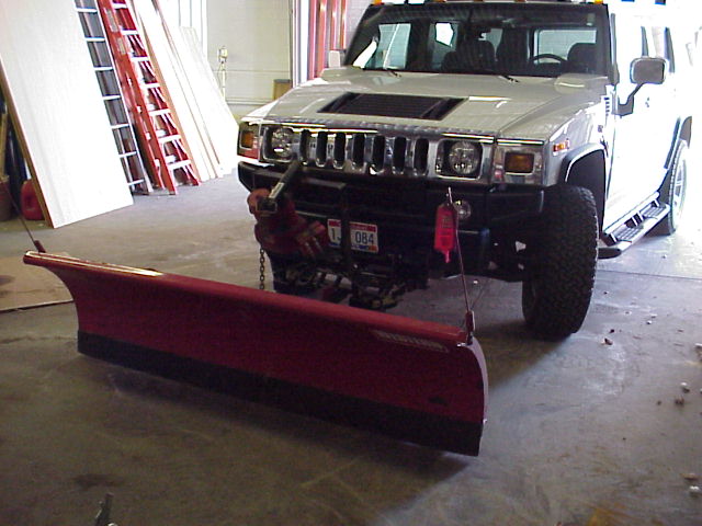

Roy, I have a Western plow mounted on my H2. I had to design and build the mount myself because Western is to slow to respond. I plowed 6 inches in our area this weekend and the H2 performed flawlessly. We did not get buried like you , but have freezing rain for 5 hours prior to the snow. Your receiver hitch will hold a small alumn. consumer plow but not the hydralic commercial versions. These need to be frame mount to distribute the forces from the plow a-frame. The standard mount for the GM product will not work because they removed the front 6 inches from the H2's frame. It you want, I will post some pictures of the H2 with the plow attached. Jay

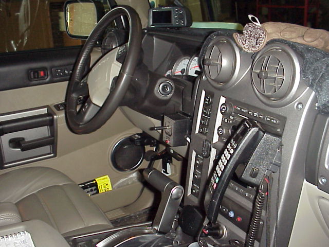

As promised, but a little late, the snowplow pictures. Jay
Old 02-19-2003, 06:22 PM
JayH JayH is offline
Location: Sioux Falls, SD
Posts: 17
JayH is off the scale
The mount.

The control.

That is just TOO cool.
You must really get some looks, I bet not too many people have seen a Hummer with a plow on it.
Actually, when you think about it, a Hummer would make a great plow vehicle. 3/4 ton frame and drivetrain, good engine power, 4wd, the rear locker and the traction control, big tires for good traction, and alot of weight.

I actually had quite a few comments last week. That was the first time I plowed this year, even though I built the mount last October. Truck works great to plow with and as an added benefit my backup camera works great when plowing. Jay
