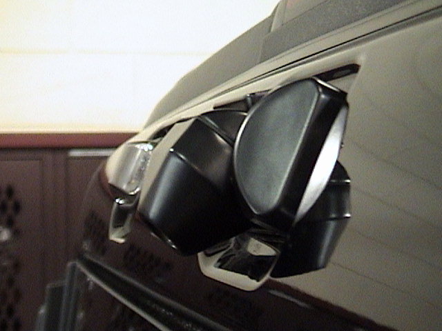

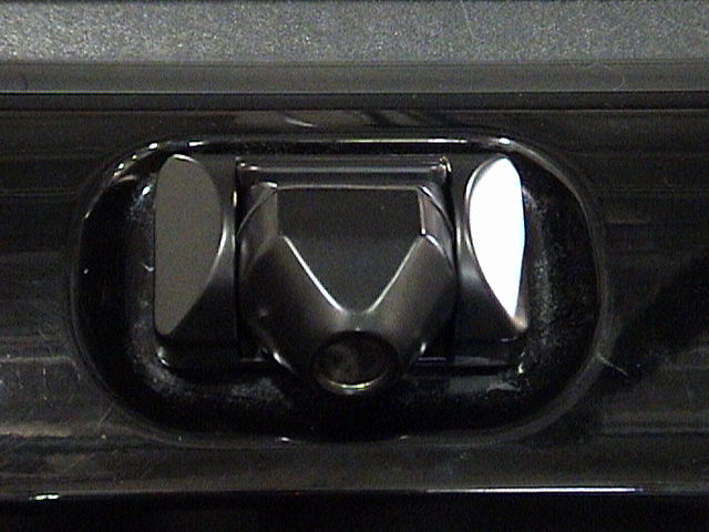

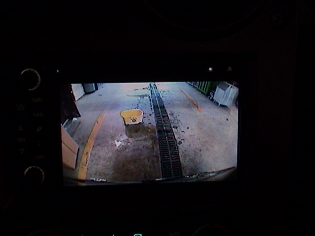

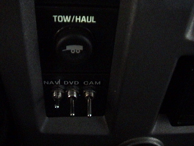

Well i figured it out. i realized that the trailer wiring works even with the off road lights it is the trailer brake that wont. but i hooked up the wires thrugh the right rear tail lamp assembley tapped into the reverse light positive. and ran all the cables to the front and placed a diode in the reverse light positive line. obtained another power source and the unit plays through the NAV system it is set up using the pac-audio adapter that i got for the stock NAV to allow the indash DVD player to work with a switch. the pac-audio adapter allows for 2 video sources to be hooked up one becomes a default wich when placed into reverse the camera automatically comes on the screen while in drive or any other mode i throw a switch and the camera plays through the NAV unit. here are some pics

orange its a real nice camera has a great field of view i can see from about 1 inch from the receiver to at least 20 feet back as well as good side vision. it is a real crisp picture.
you can see the tow hooks on the rear bumper. so i am sure i shouldnt have any issues with a ball installed.

Great install and pics. You gave me a great idea if you don't mind me stealing your idea. I love the toggle plate to switch between NAV and DVD. Very professional look.
