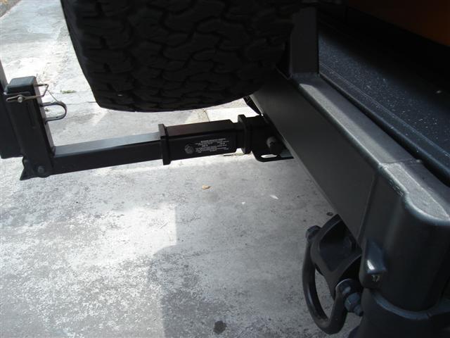

This is the extension. (Hummer brand)...

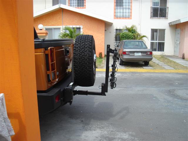

This is how much it sets off from the spare tire.
(Note the lean)
This is the Thule rack. It would have almost fit if the tire wasn't so big.
I usually take a ratchet strap and tie around the rack and the tow hoops.
