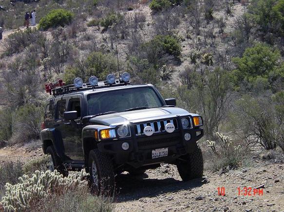

Today, the dealer finished installing the Eaton Locker I purchased from Trail Duty.... The rear Eaton locker was $845 from Trail Duty and the Dealer charged $625 to install. The locker is not hooked up to the computer so I can lock the rear diff even when I am not in Hi or Low...The direction says to slow down to 3 mph to engage locker. Also, the button to engage the locker has to be pushed in far to turn on. That it is very difficult to turn on by accident. It also lights up yellow and is very easy to see. Can't wait to try it out this weekend....

Thanks NEOCON1.... I have been waiting awhile to do this... The dealer cost to install is identical to what other off-road shops in the area wanted to charge for the install.. The last thing I need to do now is add some 35" muds....
