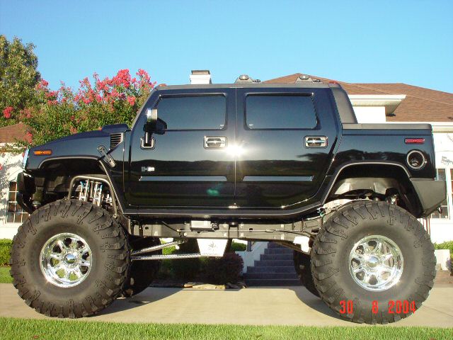

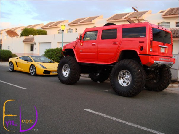

Hello i am thinking of buying a lift kit with a set of tires for my H2 SUT.
I am thinking Very BIG fat tires with a 12' lift kit !
can anybody point me to the right way where i can perches all the things that i need to make it a complete safe drive-able kit at one place and have no further problems with installing and using .
This is a photo in my mind i want the same kit with tires i really love this hummer and how much will it cost with every thing needed ?

I would think that any one of our trucks with a 6 or 9 inch lift would still make it king of the road over there.... I would doubt (I'm guessing) that there aren't a lot of lifted H2's over there.
I installed a 6 inch on mine and wish I would have done a 9" lift instead.
Keep in mind one problem, when you start getting LARGE tires, the gear ratio gets cut down. I took out my 4:11's and put in 4:56's and my tires are 38's. The tires on your pics are waaaaaay bigger than that. The truck would be an absolute pig to get a rolling start.
It'll put more strain on the suspension and I promise though it looks cool as hell, it's simply not practical.
Just for the record, installing the 6" lift is a weekend event. Not a big deal, just more time consuming than anything.
For reference size, that's a brown bear under my truck...
