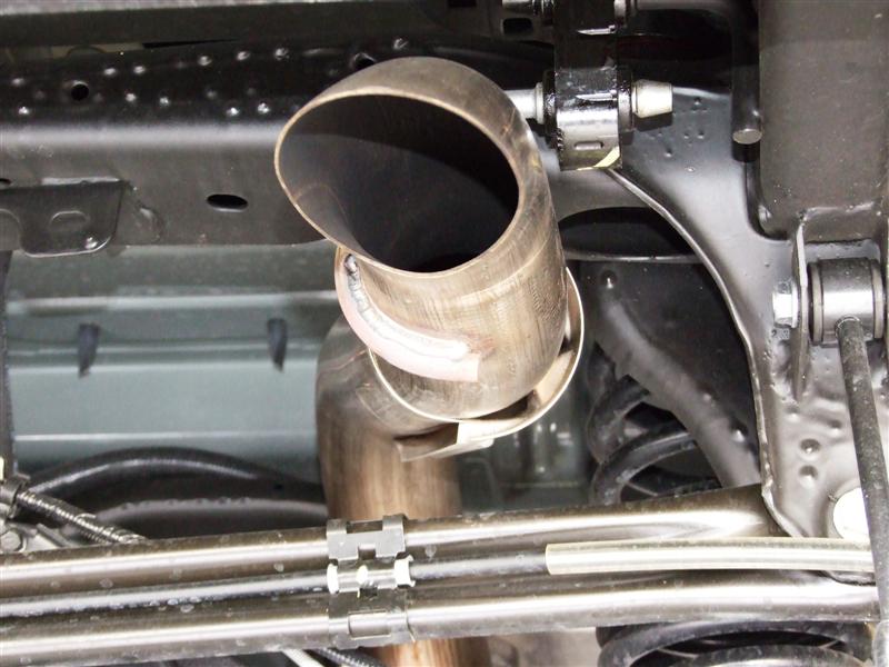

Default Re: What do you guys think of this exhaust system?
I kind of like this one. Predator MotorSports 4" polished ct back. As far as I'm concerned they could sell me one without the polishing since mud will cover up that shiney stuff pretty throughly.
