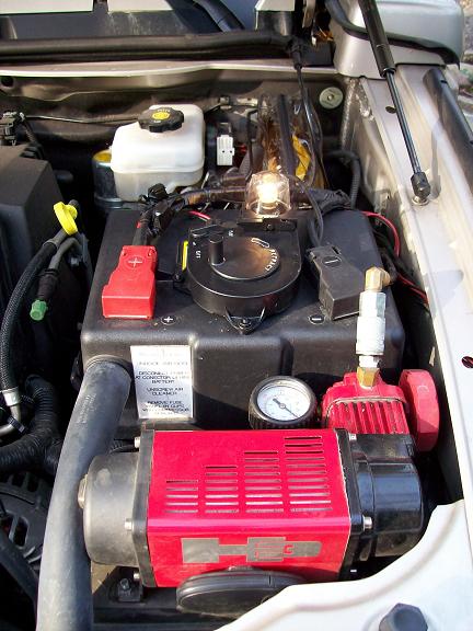

Go with 37 after a day at the beach then check next morning.
Make sure you have a good digital gauge that has 1/2 pound increments.
Also If you wheel you should carry a compressor.
A masterflow fits in cubby,custom fit to jack compartment or like I have installed under the hood.(check search for install info)
I also carry a coily hose with a gauge in case the line is to long at the beach(they have extra air couplers if you have your hose.)
Its good to have tire deflaters also(I set mine for 18lbs)

Default Re: Gauge Cluster, low tire pressure light and more
Attachment 42842
Attachment 42844
What is that between the battery terminals on top of the box ???
That my OEM GM underhood light it has a 20 foot cord ,magnetic and suction cup mount,I posted install last year .
http://www.elcovaforums.com/forums/s...ght=hood+light
I picked it up on ebay. http://cgi.ebay.com/ebaymotors/Under-Hood-Retractable-12-volt-Auto-Work-GM-OEM-Light_W0QQcmdZViewItemQQcategoryZ42613QQihZ006QQit emZ160148845834QQrdZ1QQsspagenameZWDVW
