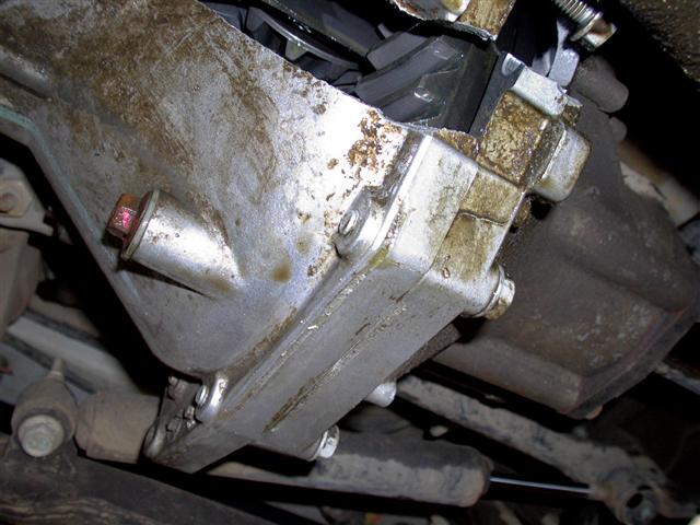

I heard a loud bang and there goes the front Diff. Cracked all the way front to back completely grenaded. So I need a new houseing and all. Any ideas who can help where to get it and if I should replace myself or should it be a pros job. I have replaced my H1 trans. case couple times other minor mechanical know how. What should it cost and all. THANKS>> Nate "Diff Destroyer" Dog..

Found a diff. for $150 online, out of a 05 H2 is that the same gearing everything and I have the other out already. So just putting the new one back in and off we go. Running 20 inch rims 35 toyos. Wasnt doing anything crazy but found out my diff fluid was a little low.

Don't feel too special - cracked front diffs aren't an uncommon occurrence in the '03-'04's. There was a design flaw in the casing that cracked quite often. I had one that was just developing a hairline fracture and H2Rocks had one go Humpty Dumpty.

Any idea if there is a technical advisory re: the front diff? For those of you having the problem what year (we are 2004)? Did you get the service 4WD message on the DIC or did it just bomb? Ours made noise the first time
(2006) and we had to have our mechanic point out to problem to the dealership (Lund). We had driven from AZ to CA and back just the month before. Lund fixed it outside of the warranty (cost us 100$). This time (one year later 10/2007) the service 4wd message came on just outside of Page, AZ on our way home from UT (SLC). The front diff was low but no noise. Seems long distance driving at a relatively high speed may cause the problem to progress rapidly. Any input greatly appreciated. I plan to talk to GM next week. Wish us luck!

Just a little info, you can blow up, grenade, destroy (however you want to say it) the front diff and the service 4wd light may never come on. The light comes on to inform the driver of electrical problems in the system, not a mechanical failure, but an electrical problem can lead to a mechanical failure. At 150.00 (especially usd, kidding) is a smoking deal. The short side stub shaft is worth more than that. I know of no service bulletins regarding failures, have seen a few fail though. One thing i will recommend is too much maintenance is not a bad thing, if you do it yourself its money well spent.

HUMTECH - -thanks for that point re: servic 4WD. Given we were on the rd. we pulled out the trusty manual and as you point out there was no real urgency in re: to the front diff.. just "you can clear the DIC and have it serviced". We added about a quart of gear fluid because paranoia has set in from the first blowout (good thing my Man used to replace front diff.s for a living!!). But I take difference with too much maintenance - it is too much $$$ coming out of my pocket for an expensive, high profile vehicle with less than 65k miles. To that point if there is also some electrical problem well just add on the bucks. But! The check engine light is a bit flakey and the clock resets when the gas is too low. I will be sure to bring that point up as well. But still .. if you all out there see a pattern with front diff. problems don't be a sucka.. call GM on it.
