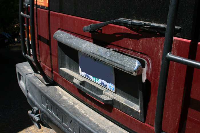

Whats it gonna take to fix??
Any Ideas Drty?

Oh man! That sucks! Was it a vanity plate that would piss off a tree hugger?

looks to me like he whited out the plate for privacy reasons but the damage around the plate, 'pat on the back' for whoever did it.
Any Ideas Drty?
I've got the same problem........let me know if you find a fix

I had same problem i removed back door cover and found screw posts I used epoxy to glue them back
let it dry for 24hrs before I assembled again
Still solid

Mine has been loose for years, prolly since I bought it. Sounds like bochard has the right idea. I was quoted $450.00 for a new one at the stealership. Mine is black, and I wanted one with the chrome on top. I'll trade ya!
Were they trying to steal a vanity plate? What'd you put on it? That didn't happen in your home town did it?
Still solid
i did the same ,works great now ! just have to remove the inside rear pannel to get access , not to hard easy after you do it once.

Id like to paint That Chrome part on my Rig, How does that assembly come off, I mean come off the proper way?
Inside panels have to come apart?
Thanks
That sucks, what were they after and why?

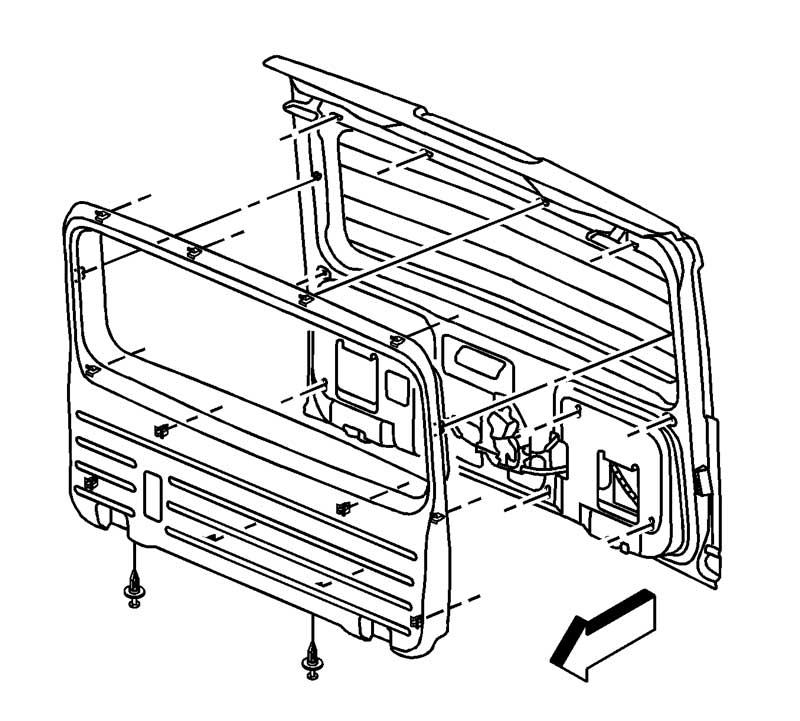

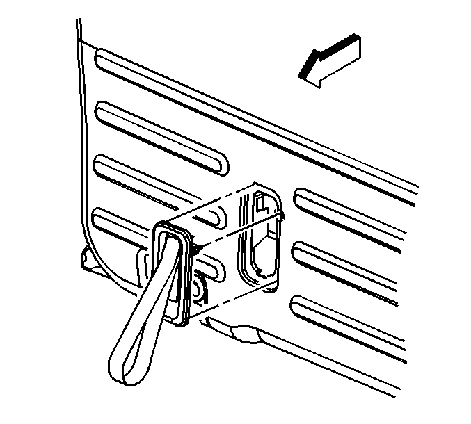

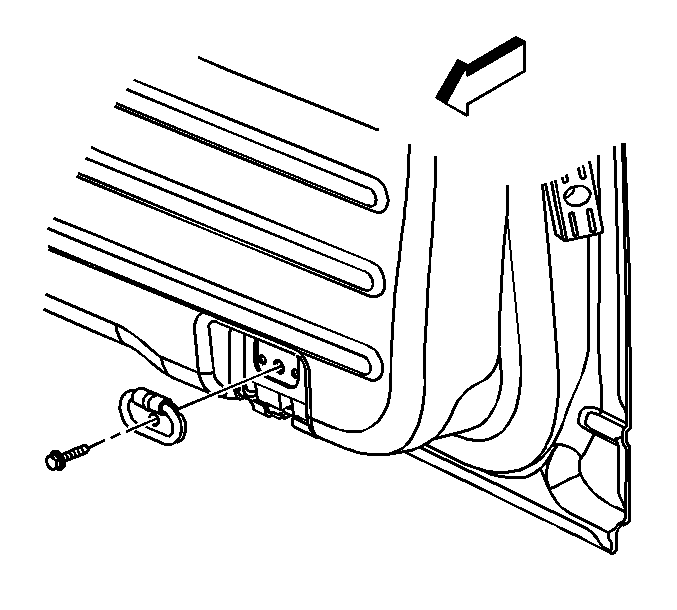

Remove bolts that hold hand loop and hooks
after that it just pulls apart its held togeter with plastic clips
Similar to these
once removed look for bolts that hold the licence plate holder in place

Groovey diagrams courtesy of KenP & CP!

Thats what I meant
Great diagrams
Those are groovey. Thanks!
