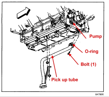

The pump pick up on these trucks is bolted in two places with an oring seal on the end that goes up to the oil pump. This pump is not like the conventional back of the pan old school pump. This is a gearator pump on the front of the engine.. very reliable and always soaking in oil. If the pump went out.. it would be a miracle. If the truck is still full of oil and you have a tick, meaning no oil in the lifters... I am with parts guy.. something clogging an oil passage.

I haven't seen the lower of our engines personally but looking at the service manual it looks pretty typical. There is a bolt where the tube goes into the pump (where the o-ring is) but there is also 2 nuts that hold the pick-up tube for support midway of the block. In my thinking those 2 nuts would have to come loose also for it to completely lose pressure, along with the bolt that tightens the end of the tube to the pump. I would think there would still be enough upward pressure from those two support nuts to hold the tube to the pump.
I don't know what to think about the driveway deal though. I look forward to hearing the answer. </div></BLOCKQUOTE>Not trying to be funny but maybe it was Friday and they forgot to tighten both the bolts and the nuts?

<BLOCKQUOTE class="ip-ubbcode-quote"><div class="ip-ubbcode-quote-title">quote:</div><div class="ip-ubbcode-quote-content">Originally posted by LasVegas:
Not trying to be funny but maybe it was Friday and they forgot to tighten both the bolts and the nuts? </div></BLOCKQUOTE>Funny you should say that. Look at what I just posted in the Technical Section.
