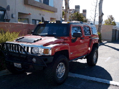

I'm runnning 35's (315/75/R16) on stock rims and having no problems. If I do a full hard right turn it Just slightly rubs but Just so I don't think you can go any larger.

Here is a pic of the 35's

just to point out the stocks are 32 inch not 29 and the 285's that you are talking about are 33" not 32" and the biggest you can go on the H3 without a lift is 35 any bigger than that youll need a lift.
