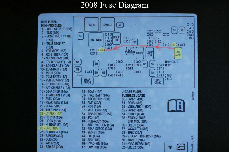

My 2005 lease expired and just re-upped with a 2008 All Terrain Blue this evening. Classy color I must say. The new interior which I have is Ebony is gorgeous. Anyways, went to do the diode mod for the day running lights jumping with the low beams and was surprised with a new fuse box scheme that totally faked me out. Has anybody completed this revised mod on a 2008 yet? If not, will take a picture of the fuse box open with the diagram scheme as well in the morning and maybe somebody could contribute and figure out what the new mod for me would be? Thanks in advance.

Below is the picture of the 2008 scheme

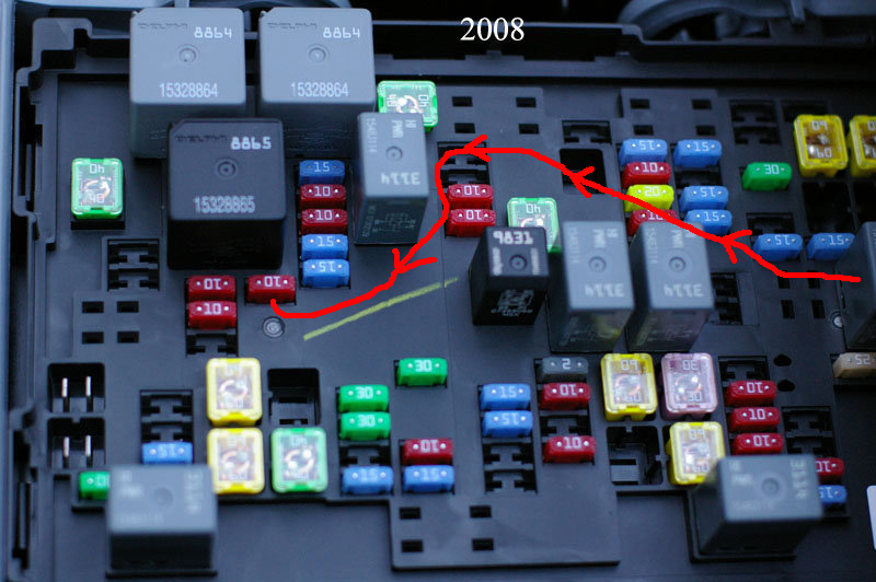

And the 2008 box

You need to run a jumper or diode from the parking lamp relay (test for a contact that becomes hot when the park lams switch is turned on) to the DRL relay (if you can find it) or to the fuse (see photo). Make sure that you go to the hot side of the fuse (the side which tests hot when the DRLs would normally be on). To find the DRL relay, you must listen for a click near the electrical panel when the conditions for the DRL change betweeen on and off (e.g. key in the on position, switch between PARK and DRIVE. Do this on level ground with wheels chocked if possible as setting parking break will lock DRL's on OFF condition. If you use a diode, place it so that current flows in the direction of the arrowheads on the drawn lines.

If you use a diode, the side with the band sould be connected to whatever source feeds the DRL's, which is to say the non-banded side toward the DRL relay.

Due to time contraints and a shorted relay, I finally got this to work with a simple jump but without a diode. Thanks again Ron and Pete for the feedback and references.
