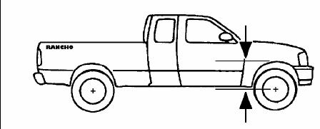

I have to do a wheel re-alignment anyway ... My point was to get truck level Front - Rear but it seems to affect ride comfort too much .
I just measured front is both sides 30.5" and rear 34" both sides.
I would like to know how much other H2?s have so please post yours.
front spindle height ?

Default Re: -06 torsion bars,keys,bolts or something else different than -03 ?
You got it, your drawing is correct. Make sure the 28.5" dimension is for a Hummer H2!

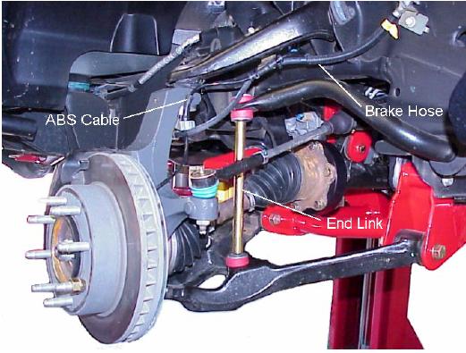

Are you saying you are able level front to rear by raising the front 5.5" by cranking up the stock torsion keys? (I wouldn't think this possible). If you are, no wonder you are experiencing a harsh ride and this is NOT advised. You will be changing the front suspension geometry and putting a lot of stress on the UCA ball joints (UCA = Upper Control Arm) among other things.
Read <THIS ARTICLE> to get some insight to the geometry of the GM front suspension. This doesn't really apply in your case considering you've already lifted your ride, but it will give you an idea of what happens when you crank your torsion bars.

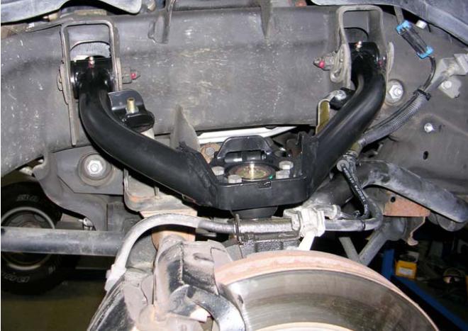

Cognito leveling seems to be only good front leveling kit but I dont know will it work with rancho 4" lift they do have also new upper control arm kit for lifted applications but it doesnt give more lift I think. I have send them email but no answer yet ...

Ranchos kit doesnt come with new upper control arm. I think cognito kit might work but I´m not sure at all...
Old 04-09-2008, 09:55 PM
Hammer Hammer is offline
Location: Finland
Posts: 126
Hammer is off the scale
Cognito
upper control arm.
Location: Finland
Posts: 126
cognito
I would be more than happy to gain extra 2" front lift but would not like to lose comfort ride....

Yes, the Cognito upper control arm kit for lifted applications would be indicated for your situation. The folks at Trail Duty are highly recommended, they will answer your concerns soon.

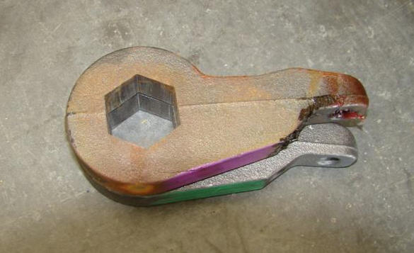

Assuming you go the Cognito route, there are other alternative torsion bar keys that will give you the lift you want:
MAXX CAM 2 Leveling kit
ReadyLift leveling kits
Trail Duty carries these also.
A MUCH cheaper alternative (about $40.00 each US). is the Chevy 1/2 ton "green" keys (green is just a color code). They're really the same thing. If you have a GM dealership in Finland you can order these. They look like this (the difference is obvious, the H2 key is the one on top and the Chevy key is the one on the bottom):

what I´ve been told
if I crank my stock keys to archieve +2" lift or buy these aftermarket keys same result: stiffer ride (if used without cognito kit) .
I might not need aftermarket keys with cognito kit if I can crank my stock keys to archieve lift I want right?
"Maxx Cam 2 can lift the front of your truck up to 3-full inches or lower it 2.5-inches with virtually no loss of ride quality"
"ReadyLift® keys are guaranteed never to affect the OEM ride and will not add more pressure on the stock suspension components."

if I crank my stock keys to archieve +2" lift or buy these aftermarket keys same result: stiffer ride (if used without cognito kit).
Yes, but the stiffer ride is caused by the fact that the shocks and upper control arms bottom out to soon. And even if the correct replacement shocks are not bottoming out any more, the factory upper control arm is still bottoming out on the bump-stop way too soon, this is what is giving you that stiff harsh ride
Right!
Not true, because the UCA is still bottoming out on the bump-stop way too soon.
This really is only half true, but cranking the torsion bars will not add more pressure on the stock suspension.

got mail from Phil and Cognito works with ranchos lift.
Both cognito kits works: upper control arm ball joint desing and stronger choise would be uniball upper control arms..
I´m just thinking is the uniball desing worth 220$ The ball joint isn´t the weakest point of front supension I think..

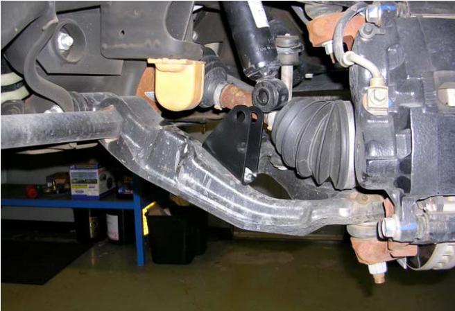

Hammer, if you do any serious off-roading in Finland then you should know that the real weak link of the H2's front steering components are the tie rods.
Check out <THIS VIDEO CLIP> to see why.
Anyone into serious off roading should replace the OEM tie rods with the <Fabtech Tie Rods>.
