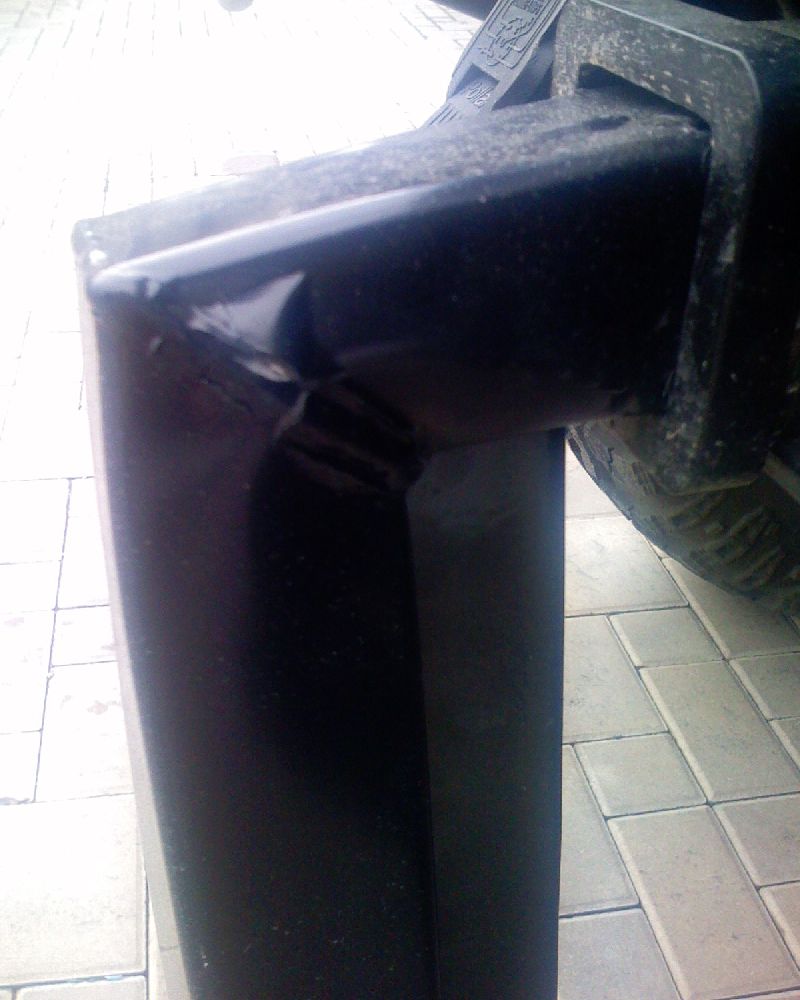

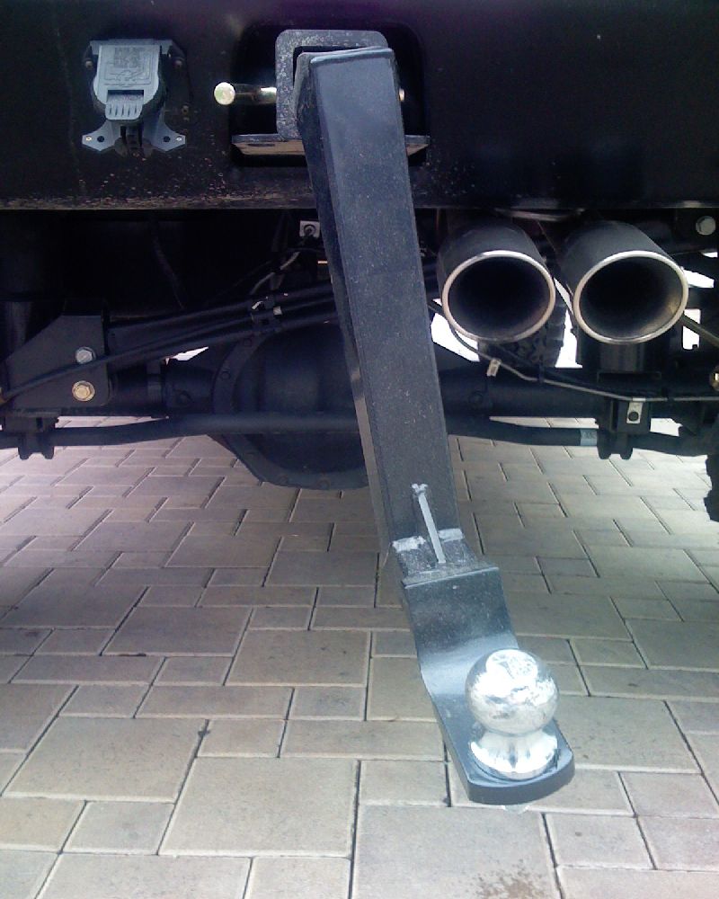

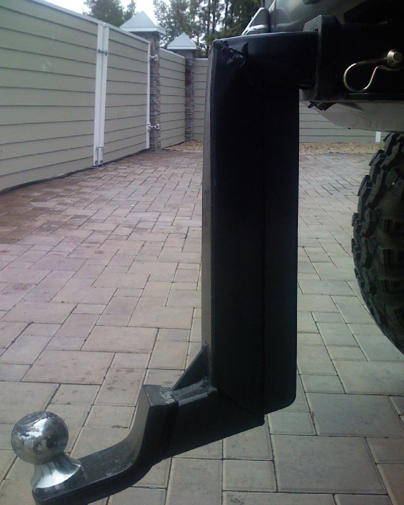

I had a 16" drop hitch made so I could tow my boat. Today I was backing it up and my trailer brakes locked up and the hitch buckled under the pressure. This is a warning to everone, make sure your hitch can handle the load!!

Originally Posted by Rhyno
I had a 16" drop hitch made ...
What a horrible design!

Nice Malibu man! I have a Supra.
Anyway that is alot of leverage at 16inches of drop. I have an 8 inch drop. I really think that trailer needs a lift kit and some mudders to make it HUMMER worthy! lol

Let me see if I can find a site that I bought my drop from. Its very heavy duty. Its only an 8" but rock solid.
You might need to talk with an engineer since you are creating one heck of a load on that drop hitch and get one designed for the specific loading of your boat.
Wasnt it Archemedes that said....give me a long enough lever and I'll move the earth?

Default Re: drop hitch
I have had a new hitch made out of thicker steel and had no problems. Thanks for all the help
