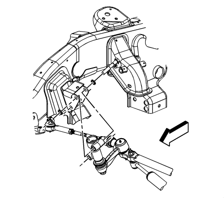

now getting underneath the H2 to swap the parts, i notice there is another idler arm similar to #1
so #2 connects to the steering part that actually turns the wheel.
#1 mounts to the frame, where the similar idler arm is conencted to it and mounts to the steering arm right next to the steering stablizer.

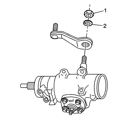

Hi the 2 parts you bought bolt together then to the frame. So have the correct parts to change the complete idler arm. The mystery idler arm as you called it is the pitman arm and it mounts to the bottom of the steering box. If the idler arm on your truck is worn out make sure you check the pitman arm as it maybe in need of replacement to. Hope this helps.

im guessing i had the wrong parts, as the pitman arm had splines in it, and assume it is the one that connects to the steering box.
so i still needed a pitman arm.

Hi the pitman arm connects to the bottom of the steering box it has about a one inch hole in it with splines inside of it.
