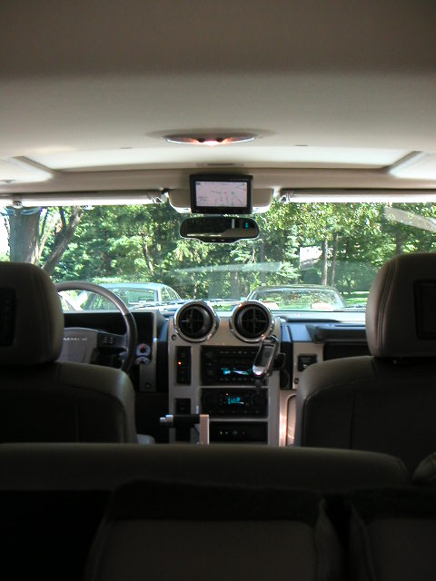

I'd like to install my navigation monitor overhead like in the photo below (I'm not sure who's install this is). Does anyone have experience of doing this? I'd like some details regarding how exactly to attach the monitor to the roof moulding and how easy it is to route the cable.
Thanks,
Mark.

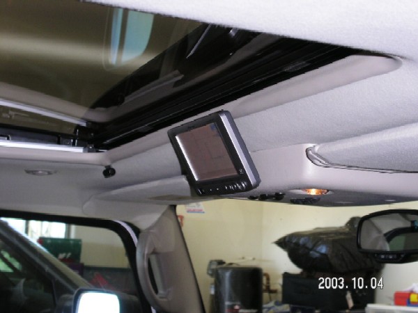

Old 03-12-2004, 07:01 PM
Tucson Beast
Hi markw
This is a picture of my monitor - I am very busy but will try later to explain this installation and provide some other pictures. I will return

Old 03-19-2004, 10:12 PM
Tucson Beast
Hi markw

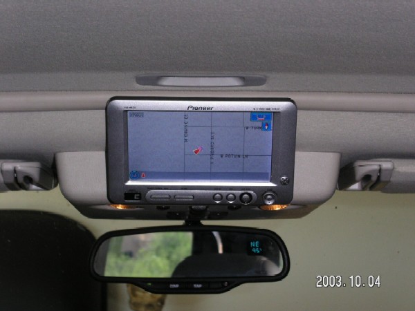

I had a professional shop install the monitor. What they did after we looked a few different ways, was to take a nice L-brace (1 1/2" to 2" on each side) and bend it open to the correct angle to allow the monitor to angle correctly and to sit flush on against the console at the top and bottom point of contact.
The brace was secured to monitor and to the top of the ceiling space covered by console. The wiring was pulled through the already-drilled-hole I had in the console for dealer install off-road lights (so as not to drill another hole in console).

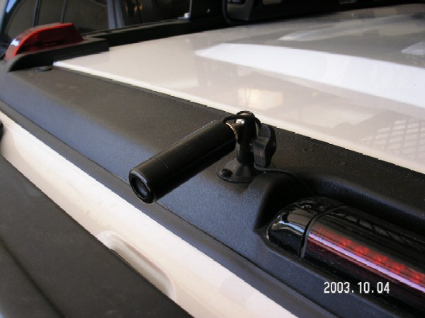

The navigation system (DVD) was placed under back seat - all wiring was routed to the A-frame column down into console. I also add a rear "Lipstick" camera on the rear top of the door (it faces down and out giving me a wide open view of the back). This very funny to watch the people in the car behind me at stops.
As you can see by the picture you selected - it looks like a factory install and that it was made for the location.
Hope this helps
Old 03-19-2004, 10:16 PM
Tucson Beast
Hi markw
Here are a few more pictures:
Old 03-19-2004, 10:18 PM
Tucson Beast
Another
